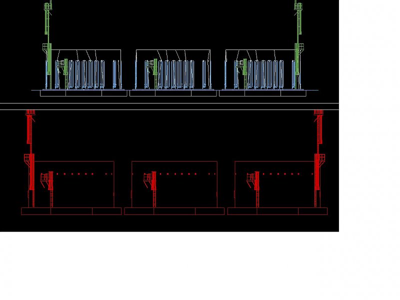

piping does noy show in section
ok, attached is my model (top) and the resulting section..... what happened to all my pipes? anyone?
I'm MEP 2009 64 bit
Can you post the drawing?
no need, Autodesk Support fixed me (they rock)
I had my section 'setting' set wrong...once I changed it to MEP Design-Model it came out right...
