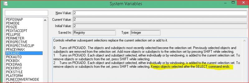

Use P for Previous selection set, they are still in memory.
Thanks, but I know that one. But it doesn't KEEP them selected.
