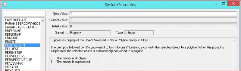

You might consider using PEDIT > Join option, as it may have MULTIPLE selection..
