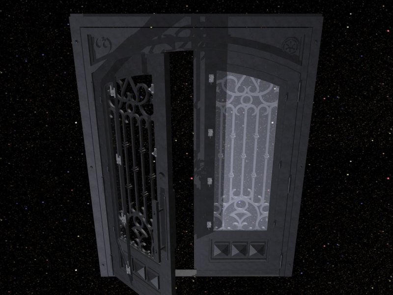

Been using Inventor for 3 years with only need for 3 parts in my assemblies. SaveAs and Replace Component were the easiest way I could find to create easy, fast, repeatable parts. I use iProperties to drive my assemblies and they don't break and things look great. I now need to make large assemblies consisting of 40-100 parts. Saving this model as a revision or copy would seem to be a easy thing but I am totally missing something and have been beating my head for too long. I know that using iPart to create the parts and starting them from a Project to organize them is the best bet but I have never gotten it to work. Figuring out how to save and rename things so they don't go crazy has eluded me. Any help would be appreciated. Thanks.
I have been reading two large Inventor books and what I can find is that using Project to start, then creating a part, converting? it to iPart, creating Assembly, inserting iParts into said assembly. Are there any tutorials that anyone knows that might specifically direct me to my problem. I know I am super close but keep breaking things and don't know where to find the best answer for this. Over a hundred views and no answer is either something no one wants to share or a common problem that not easily answered. I will keep looking myself but a bit of direction on where the iPart and iAssembly are usable and repeatable for multiple projects from a similar design.
