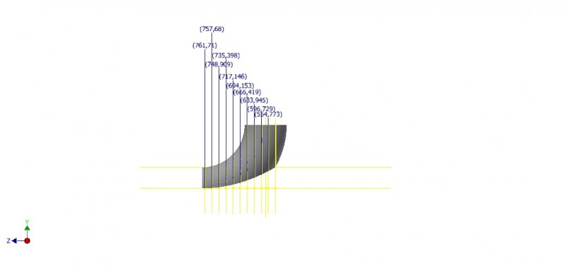

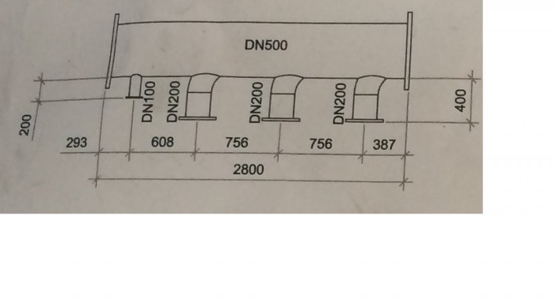

I need a sugestion to do this sheet metal preparation.
There is a pipe ND 500mm (like a manifold), that will ou curve what i need is just the intersection between the 500mm and 200mm pipes. I need to respect the vertical dimensions.
What is the best way?

The project change, and will be the intersection between a curve and a pipe with 500mm.
To do the object is easy (i think), but the annotation for me is dificult.
I need the several points (like 12 points with a gap of 100 between them) of the delimitation of intersection berween the curve and pipe, to mark the curve to cut. this points generate annotation verticals and horizontals to help the fitters to mark and cut the curve, and then weld.
Do you understand?
I tried to do with plans and project geometry, but there is another way.
Thanks for the help
