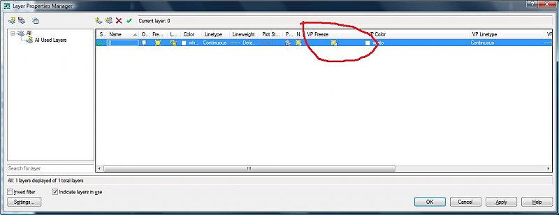

Instead of freezing the whole layer throughout couldn't you just use VPFreeze for that viewport?
the background mask was a good idea but in the block i also have a little triangle (symbol that we use to show bearring connexion), that's why my coworker made a wipeout around the text and triangle. As for the VPfreeze, that's what we did, but we can still see the outline of the wipeout above the buildings lines.
