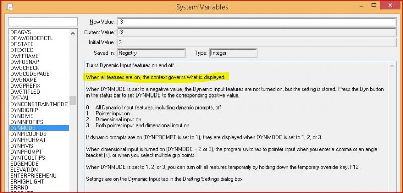

Somehow dynamic input has been turned off (set to 0). Check DYNMODE. Dynamic input has to be on (1, 2, or 3) for the list to display by the cursor. Otherwise it pops up over the command line. AutoDesk figures if you don't want dynamic input showing by the cursor, you don't want anything there. Some hate it, some love it.
As per Dana's post, here is a screenshot taken from the SYSVDLG command display box, which explains the various settings available for the many different system variables in the software.

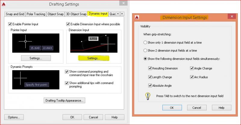

For those who enjoy using Dynamic Input, there are quite a few ways it can be customized, as per the screenshot about Drafting Settings.

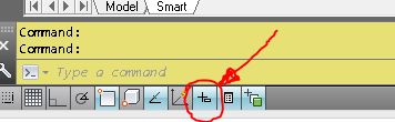

Yes! Thank you Dana & Dadgad! Fixed.
