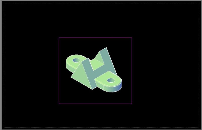

An example of a paper space viewport (the magenta colored box) with an isometric view of a 3D model that exists only in model space. Note that viewports can have a scale assigned to them. So, for example, I could show the 3D model in two different viewports each with a different scale.

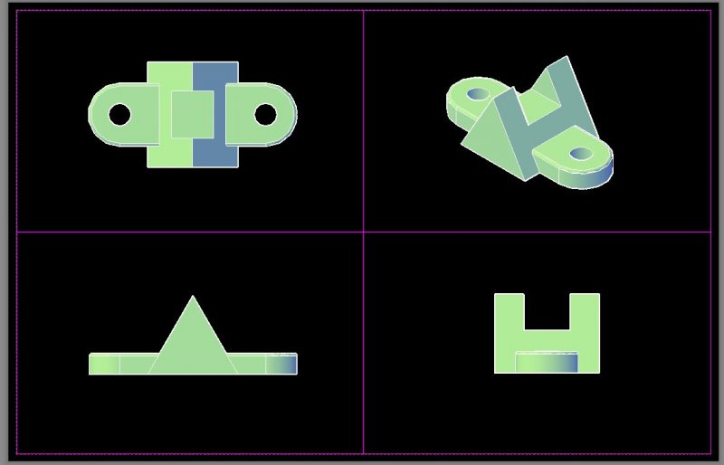

Another example but this time I set up four viewports each showing a different view and all set to utilize the same scale. BTW...the visual style for this example and the previous one is Conceptual. Keep in mind what you are seeing is a series of 2D views of a single 3D object. These are not actual 2D views extracted from the 3D model. That would require the use of different commands and the results would look like 2D wireframes. Understand?
