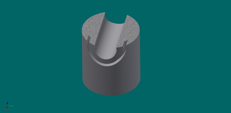

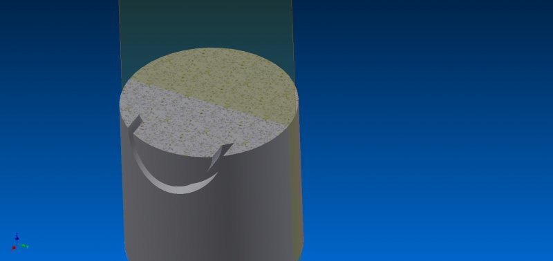

johhny comelately Posted May 11, 2015 Posted May 11, 2015 the engraved circular slot around the hole has to have perpendicular sides and be square to the plane. using the engrave tool it gives the choice of "engrave from face" which produces the bottom of the groove to be parallel with the outside face. it is needed to be a flat and square bottom , ie, parallel with the plane. can anyone help please Quote
johhny comelately Posted May 15, 2015 Author Posted May 15, 2015 this groove is for a seal to move in axially with the hole. is there more clarification needed? Quote
ConMan Posted June 26, 2015 Posted June 26, 2015 If the seal is moving axially to hole wouldn't it be possible to do this as an extrude cut? I've never used the emboss/engrave tool but it looks like it's for wrapping a sketch to a non-planar surface and then adding or subtracting a set distance from that surface. If you want a "square" bottom I'd try extrude cut. Unless I'm missing something, there's no file to look at... Quote
johhny comelately Posted June 26, 2015 Author Posted June 26, 2015 conman, an extrude cut produces the slot bottom parallel with the sketch or plane, whereas this needs to be parallel with the solid's curved surface, which is what engrave does. and yes the seal does move axially to the hole. if you use a extrude cut profile perpendicular to the desired circle via a sweep, the path has to be generated by project geometry 3d ...........maybe that would work?? Quote

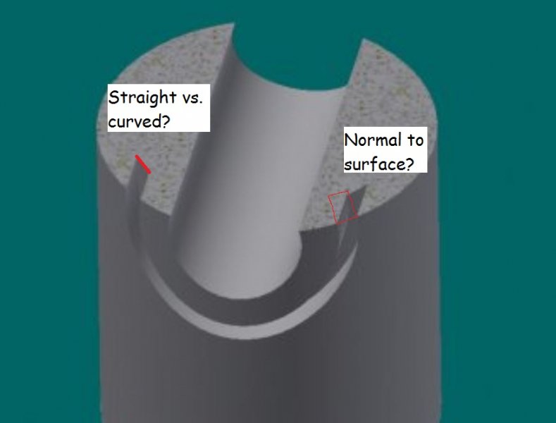

ConMan Posted June 26, 2015 Posted June 26, 2015 Well I'm not really following what you're looking for then. In your first post where you say the bottom of the groove needs to be "parallel to the plane", what is "the plane"? Do you mean the curved surface of the overall piece (which is not a plane). See my screenshot below. I guess I'm thinking you might be looking for one of two things, either the option on the left where you want the bottom to be a straight line instead of the outside curve offset down the groove (likely), or you want the option on the right where you want the groove normal to the surface (unlikely and difficult to make in real world I think). Option 1 would have the bottom straight but not perpendicular to the two sides whereas Option 2 would have the bottom perpendicular to the two sides but the whole thing skewed inward. Perhaps the easiest would be to draw a sketch (on same plane as my Option 2 below) but of the desired groove shape. Then just revolve that around the hole axis. If you do get this figured out post a screenshot or ipt file so we can see what you were looking for. Quote
johhny comelately Posted June 26, 2015 Author Posted June 26, 2015 in your image the notation "straight vs curved" the slot needs to have a square (to the slot sides) bottom that is parallel to the origin plane whether it be X or Y. the slot is correct, NOT to be like the notation "Normal to surface" thank you for helping Quote

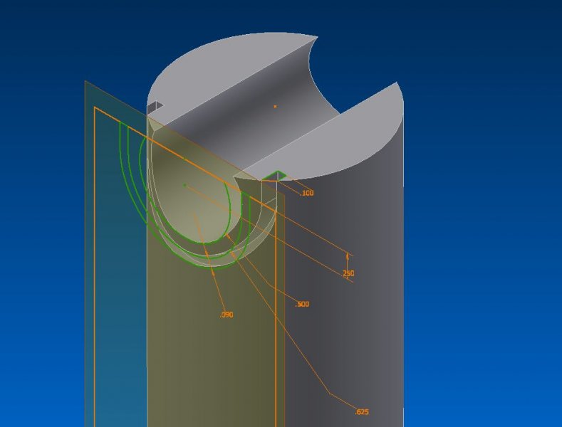

ecshclark Posted June 29, 2015 Posted June 29, 2015 Create a 3D sketch by projecting the path of the slot onto the face of the cylinder. Create a 2D sketch of the slot profile on the top surface/plane of the cylinder. Using Sweep cut the slot profile along the slot path. The depth of the slot will be constant from the face of the cylinder, and the bottom of the slot will parallel to whatever you made it parallel too in the slot profile sketch. Quote

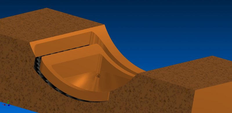

johhny comelately Posted June 29, 2015 Author Posted June 29, 2015 thank you ecshclark, i did try that originally, and it did not work this image i posted was supposed to be represenative of the actual model, which is a proprietary job. the path is up hill and down dale. i will endeavour to recreate the slot as it actually is and maybe then we can have another look at it, i thank you for your patience Quote
ecshclark Posted June 30, 2015 Posted June 30, 2015 The images looked to be the opposite of the images before, i.e. the mold cavity. So I'm not sure what you are trying to do anymore. Orthographic views of the feature might help, or the model you've attempted. You don't say what is not working with the sweep. The feature geometry is not correct? Or you can't get the sweep to work? Attached is the model my previous image was taken from. Part1.ipt Quote
johhny comelately Posted June 30, 2015 Author Posted June 30, 2015 the area of concern is the bottom of the slot which has the carbon fibre finish, when sweeping a squared off profile (from a rectangular sketch like you showed) as the sweep goes along the initial path whether it starts on the curve or the straight part of the path , when it changes to the other the square bottom does not maintain because it keeps its original "squareness to the starting orientation. (it doesn't pivot to suit the new orientation from straight to curved) the carbon fibre surface has to be parallel with the (imagined plane) therefore square with both sides. again thank you for your assistance Quote
ecshclark Posted July 1, 2015 Posted July 1, 2015 (edited) Sorry, I never looked at what it was doing in the middle, my bad. It looks like a loft would be the way to do this. You would sketch multiple cross sections along the path/rails and that would control the orientation of the slot. Edited July 1, 2015 by ecshclark Quote
johhny comelately Posted July 1, 2015 Author Posted July 1, 2015 what about going around the curves? its important for two reasons: one to be able to machine it and secondly to give a workable surface for the dynamics of the seal to work with. Thanks again. Quote
ecshclark Posted July 1, 2015 Posted July 1, 2015 Create multiple sections for the loft along the rails at both ends, tangents points, and in the middle. See attached Groove_Loft.ipt Quote
