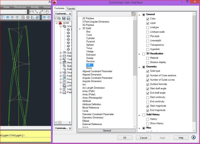

While I understand they are not for everybody, I am a big fan of them, because they are so wonderfully configurable. If you right click on the side of the palette and select CUSTOMIZE, it takes you to the cui, where you can customize which attributes you want to display for any particular type of object. You can also set it to self collapse to a very small size, unless moused over. You can also choose if the display should be parked (static), or cursor proximitized.
I hate using the regular PROPERTIES, because there is so much information there, through which I am forced to wade, in search of specific information which I would typically expect to need for any particular object type. You can also set it so that it only opens, when specific types of objects, for which you have specified attributes to display, are selected, and it ignores all other non-customized selections. It only displays exactly what you have told it to display, once you configure it, and it makes it quite effortless to access and edit RELEVANT properties on the fly. :|

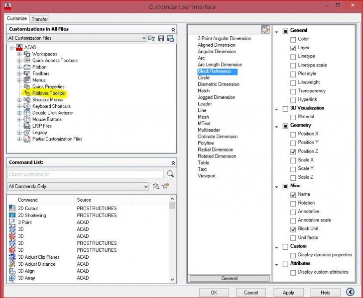

I have also configured all of my ROLLOVER TOOLTIP values too, to access specific information from objects without even selecting them, just by mousing over them.
