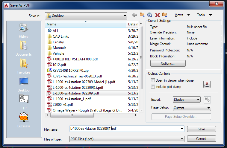

On occasion my salesman will send me a DWG file and ask me convert it to PDF or make a 3D model. But 90% of the time, I fight trying to figure out how to get the PDF to display properly or legibly. Take this following file for example:
L-1000-ss 4station 022309.dwg
When I try to export to PDF, the drawing fills less than half the page and is not legible. How do I either enlarge this to fill the page, or even more preferable, select portions to print (at full page!!)?

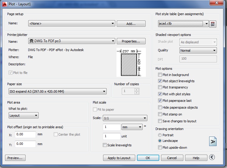

I tried two plot-to-PDF's and had no problem with either. One was set for printing to a 24x36 format while the other (a portion of the full drawing) was set to print on a 8.5x11 (portrait orientation).

I'm a big fan of using AutoCAD's 'DWG to PDF' print driver in a named Page Setup applied to Layout, and then simply enable the Autopublish mechanism, so my exhibit/sheet drawings are printed to PDF when I SAVE* my work. :thumbsup:
Cheers
Right click Layout tab, select 'Page Setup Manager...', create a named Page Setup (i.e., DwgToPdf_24x36, etc.) and configure to use 'DWG to PDF' print driver, hit OK and apply to Layout.
In OPTIONS, Plot and Publish tab, bottom left, check 'Automatic Publish' and then hit 'Automatic Publish Settings...' button. From there, consider 'Publish on' = Save, 'Location' = Drawing folder, 'Include' = Layouts, 'File format' = PDF, 'Type' = Single-sheet file, 'Layer information' = Don't include, etc.
With that configuration on my workstation, a PDF is produced within +/- 1 second at drawing SAVE.
Cheers
I do not use the export-to-pdf option. I plot to a PDF.
+1 to this. I always plot to pdf as well. Almost issue free.
Its File scroll down to plot then select dwg-pdf.pc3 sorted
