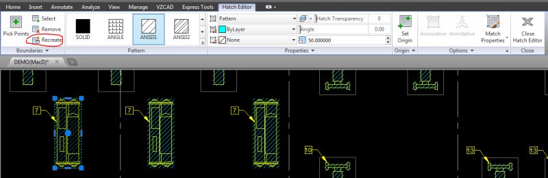

I've got several large solid hatch objects and I was wondering if there was a way that I can find out the perimeters of these objects?
It'll save me quite a bit of time from drawing a boundary around each hatch and finding out that way!
This will prompt you to select a hatch, recreate and associate the boundary, and select it so you can view the resultant Polyline's length property:

Or do it without code:
