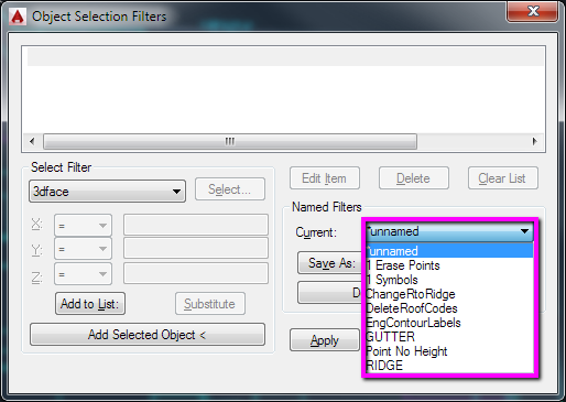

Is it possible to export the filters (saved in the FILTER command) from one machine to another?
In fact, they don't even work from one profile to another, on the same machine.
I have to keep setting them up for each new user.
Just wondering if there is a way to speed it up. They don't come across when doing a migrate setting function from the Windows Start menu.
Saved_Filters.pngThis screen shot shows the entities that I am hoping to share.

YZ take a look for "filter.nfl" in the user-roaming-etc. support path, and see what you can do with it.
As mentioned, Filter.nfl is where they are stored. Should just copy to each computer, C:\\Users\\users name\\appdata\\roaming\\autodesk\\autocad
20xx\\rxx.x\\enu\\support\\filter.nfl
Not sure of anyway to share a single file.

LONG time to reply. Yes,m this works. I found the file, opened it in Sublime Text and it reads just like a script file of each filter.
Copying filter.nfl to each user profile does copy the filters to that workstation.
I think I'll write a DOS batch file that can copy it to %UserProfile%\AppData\etc.

After finding the filters.nfl on my user profile today I copied it into the central server where I put my first "File Support Path" in OPTIONS. Previously there was no filters.nfl file on the server.
Now it works across all other machines instantly!
I think that the reason it was missing is because I started using filters more recently than when I copied the libraries to the server. So it seems that when there is no filter file AutoCAD creates one on the local drive.
A dream come true. Thanks for your help everyone.
