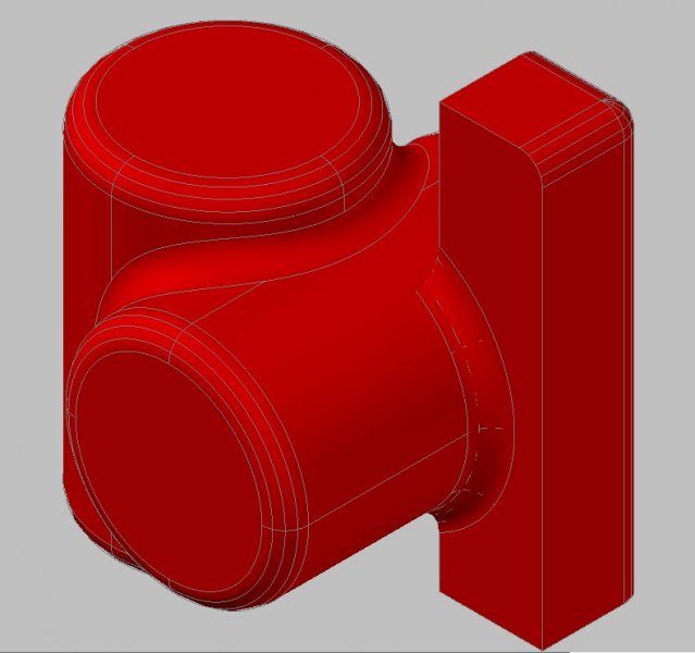

marmo Posted May 20, 2015 Posted May 20, 2015 I've checked the dwg right now. Instead of use revolving to create a cylinder with a dome you could use the command fillet. I think you will use a lot the command fillet for many edges or junctions of this model. Quote

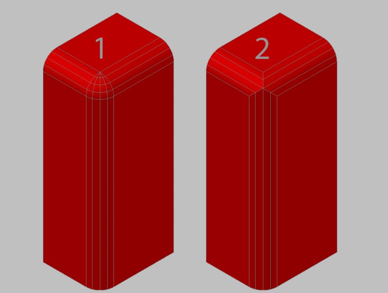

marmo Posted May 20, 2015 Posted May 20, 2015 For this model I've used the command fillet, useful for edges and mostly for junctions. Pay attention during the command to the selection order of the edges, you can obtain differents solutions... Quote

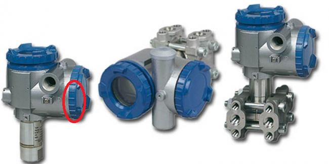

indigo Posted May 21, 2015 Author Posted May 21, 2015 Hi, I was trying to do the face of the transmitter and I like to draw the details on the side..I've placed a red circle on the attached photo ..Is it possible to draw on a curved surface in autocad.. Thanks.. Quote

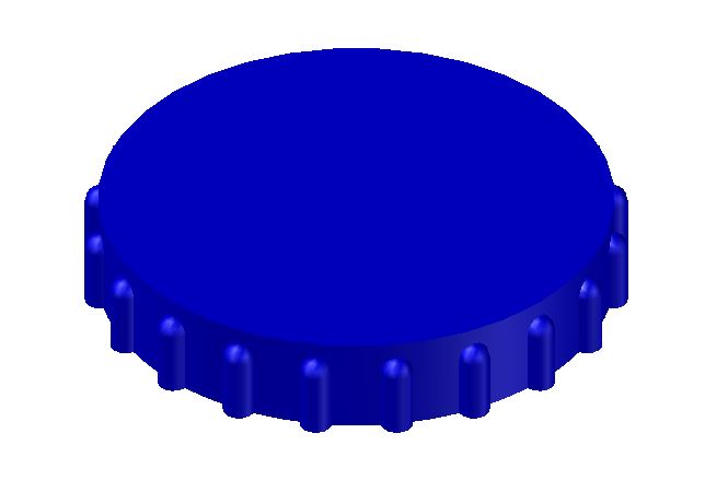

Dadgad Posted May 21, 2015 Posted May 21, 2015 You could model one of those little nubs, then once you have positioned it correctly on the base part use ARRAY with the Polar option to create them all the way around the shape. Quote
