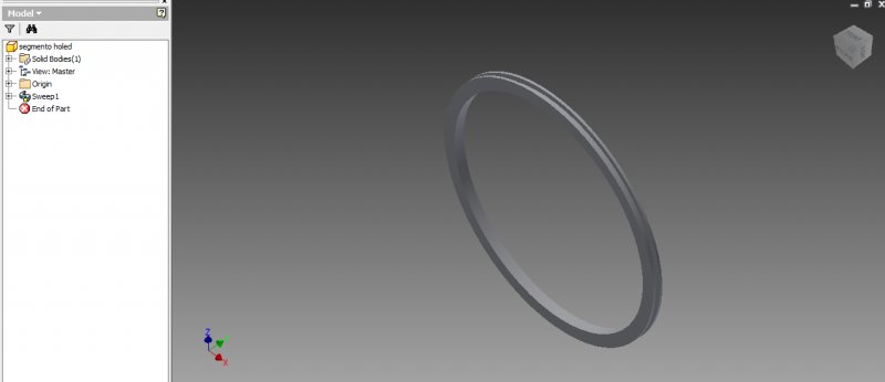

Hello . I need to make some slots in the following drawing: slot.jpg

If anyone has any suggestion I would be glab. Thanks a lot
Quick Suggestion:
Make your XZ plane Visible,
Create a new Plane Tangent to Surface and parallel to Plane
Make a new Sketch on this plane, and Extrude your First slot from there.
Then do a Circular pattern.
Circular pattern is the best method to use. The slot looks to taper, not a problem add this when you cut the extrusion then circular pattern.
