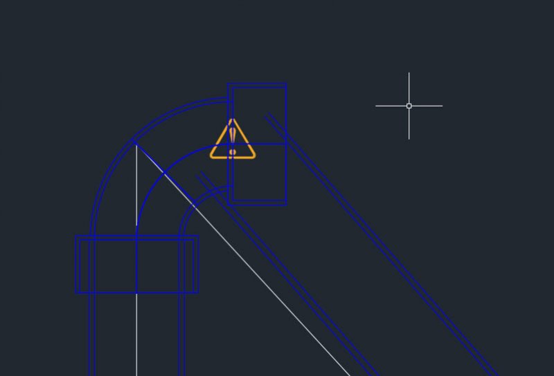

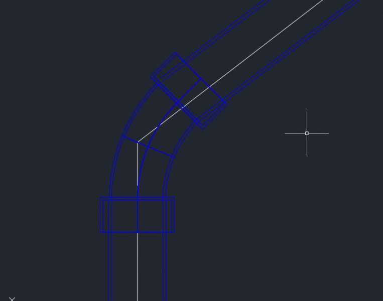

Tiger Posted May 27, 2015 Share Posted May 27, 2015 I was all ready to say that Nah, 2016 don't do anything when I realised that I haven't really tried it in 2016 yet. And then it looks like this - but a quick test in 2015 shows that the same quick and dirty test there gives me the exact same result. And I know that the command bonkers out sometimes in 2015 so I will assume that it will do the same in 2016. Quote Link to comment Share on other sites More sharing options...
CadmanPete Posted May 27, 2015 Author Share Posted May 27, 2015 Interesting. I will definitely have a fresh look at the command again when I get upgraded next week. Can I ask if the deflection shown is within the parameters of deflections for that particular bend in the part list, or is an error flagged when running a design check? Thanks again for your help. Quote Link to comment Share on other sites More sharing options...
Tiger Posted May 27, 2015 Share Posted May 27, 2015 Definatly not within allowed deflection. Quote Link to comment Share on other sites More sharing options...
