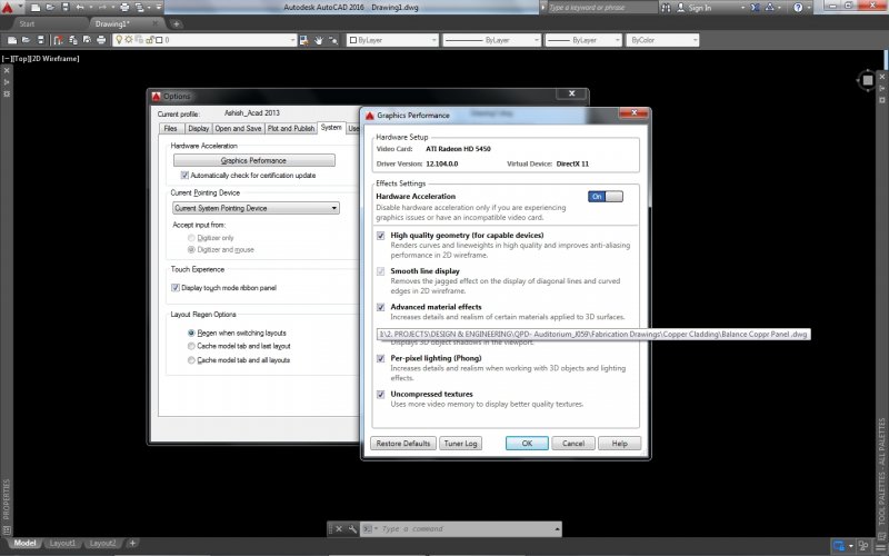

Ashishs Posted May 28, 2015 Posted May 28, 2015 I am not sure if this is a Bug in the program or if there is a setting that needs adjusting. Below is an image of my problem. All most in the middle of the screen it shows a file path of the drawing drawing that is open, and it stays there and never moves when panning/zooming or even when i have a dialog box open its always on top of it. I tried google searching but just couldn't find an answer. Does anyone here have an ideas? Quote
ReMark Posted May 28, 2015 Posted May 28, 2015 The tab for the drawing that is open has the four digit number 0501 while the on-screen reference has the four digit number 0300. So, how can it be the file path of the drawing that is open? Could it have anything to do with a missing xref? Quote

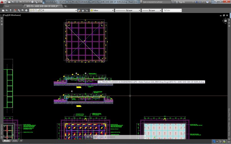

Ashishs Posted June 1, 2015 Author Posted June 1, 2015 No it also shows sometimes from the same open drawing path. See below image taken today. It happens randomly. Quote

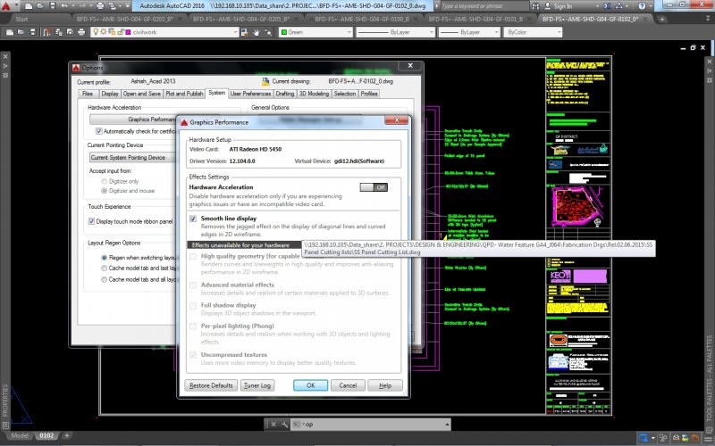

Ashishs Posted June 3, 2015 Author Posted June 3, 2015 Attached is the screenshot of graphics performance settings. I tried to switch hardware acceleration off but file path is still displayed. Sometimes from the previously opened drawing files. Quote
Dadgad Posted June 3, 2015 Posted June 3, 2015 In your screenshot, Hardware Acceleration is still turned on. Try turning it OFF, then you must click OK at the bottom of the dialog box. Quote

Ashishs Posted June 3, 2015 Author Posted June 3, 2015 I checked turning hardware acceleration off and restarted AutoCAD. But still problem appears. Note that I was never having this problem before with AutoCAD 2015 x64 on same pc with same graphics card. Have you tested this drawing on another computer? - Yes other don't have this issue as they have AutoCAD2015 x64 version. Is this the only drawing that seems to suffer this mysterious affliction? - No it happens randomly with any drawing. What is the source of the drawing? - from consultants office (from AutoCAD) What program was used to create the original drawing? - I believe AutoCAD before once drawing opened gives this message "Autodesk DWG. This file is a TrustedDWG last saved by an Autodesk application or Autodesk licensed application." Is any other add-on program being used? - Nope Have you tried a REPAIR of the installation? -Yes I did reinstalled it, but still shows path on screen. Quote

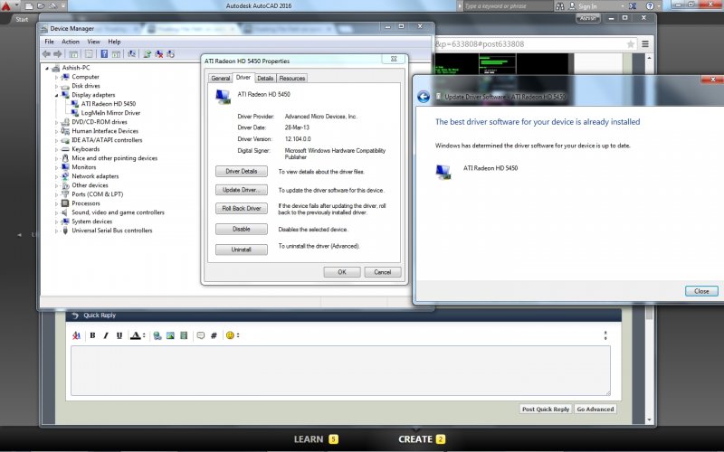

Ashishs Posted June 3, 2015 Author Posted June 3, 2015 Yes, I tried but there is no update available. Check screenshot below. Quote

RobDraw Posted June 3, 2015 Posted June 3, 2015 Yes, I tried but there is no update available. Sometimes you need to go to the manufacturer's website and get it directly from there. It might not help, though. Quote
