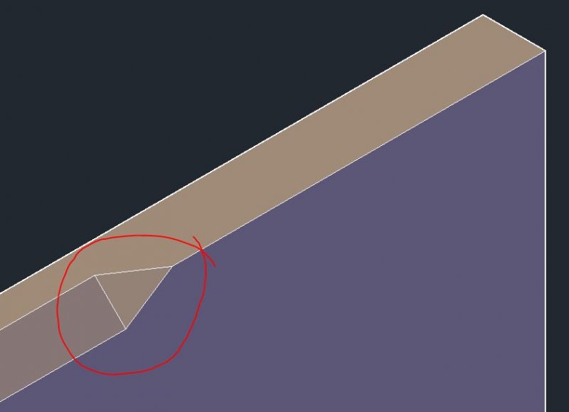

How can I chamfer just a portion ( for example 1/3 of the total length ) of an edge on a solid ?
I would like to chamfer just the centre part of the edge length and then fillet the ends of the chamfering to the original solid edge.

I tried the suggested procedure but unfortunately I failed to achieve my goal.
What I am trying to model is a partial chamfering on an edge that fillets to the original edge at the chamfered segment ends, something like the chamfering on the photo below :

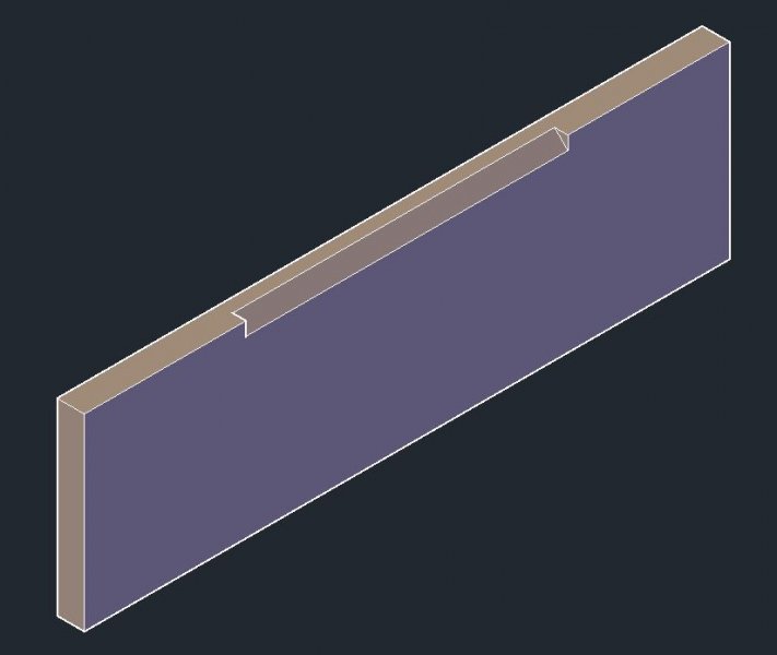

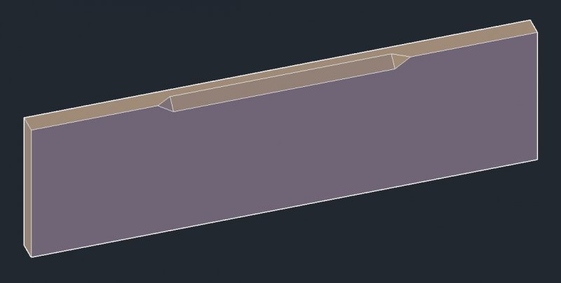

My final attempt. Got to step away from my desk for a while.
I suppose if you wanted to you could even radius the edges a bit to soften the look. User's choice.
[ATTACH=CONFIG]54358[/ATTACH]
Or more like this?
Yes, this second picture is almost what I need, I think that it will be a simple task to aplly fillet to the resultant edges.

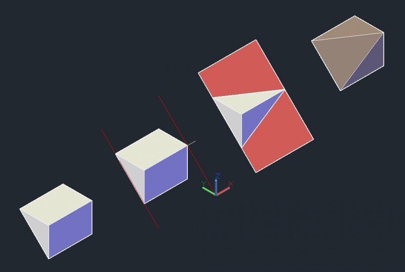

Using the Loft and Slice (with Surface option) commands I kind of did this...
Sequence starts on the left with a solid created by lofting two triangles and ends all the way over on the right with the finished product. Two lines were lofted to create the cutting surface (reddish color).
Took the finished product and placed it in my model then unioned the two together. Mirrored that then used the Union command to arrive at the result shown in the image I posted previously.
