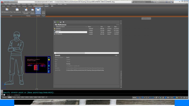

Dana W Posted June 1, 2015 Posted June 1, 2015 You can't xref objects in PS, move the objects to MS and try again.:oIt works in paperspace. I have dozens of drawings with xref titleblocks in paperspace. Here's one. Save them all to the same folder and update the xref paths. It's not the best template on Earth, but then it ain't mine anyway. Feel free to use any bits that work. GENERIC.dwg GENERIC TITLEBLOCK.dwg FINISHES.dwg Quote

Dana W Posted June 2, 2015 Posted June 2, 2015 So what do I look at to find out what space this xref is in. It sure behaves as though it is in paperspace. I can select it and move it around, etc. When I break the link, I get a little tag where it should be, you know the ones that are too small to read, right next to the insertion point. I know, I will try and xref another one in right next to it. I'll let you know how it works. Quote
Dana W Posted June 2, 2015 Posted June 2, 2015 I'm also willing to bet that the OP's XREF titleblock is in paper space.But that's not supposed to work. I don't know what space I am in. I just inserted this guy in Paperspace on layout tab 00CS. Are you gonna tell Spock that he doesn't know what space he's in? Quote
Dipali Posted June 2, 2015 Posted June 2, 2015 No, what he means is tilte block in original drawing should be in model space, then only you can xref it in other drawings. It can be xrefed in paper space or model space depending on the requirement. The object in paper space can not be xrefed in other files, so the op's original tilte block is drawn in paper space and that is the reason he can't see itin other drawing where he is trying to insert it as xref. Quote
Dana W Posted June 2, 2015 Posted June 2, 2015 You can't xref objects in PS, move the objects to MS and try again. No, what he means is tilte block in original drawing should be in model space, then only you can xref it in other drawings. It can be xrefed in paper space or model space depending on the requirement.The object in paper space can not be xrefed in other files, so the op's original tilte block is drawn in paper space and that is the reason he can't see itin other drawing where he is trying to insert it as xref. Well, of course, I knew that. After I had sat down to watch the 11:00 news, I realized what rkent meant after all. I originally misinterpreted rkent's post. Literally translated from English to English: One cannot take objects from paperspace, and attach them to another drawing as a cross reference. This facility does not exist in AutoCad. However, one can cross reference modelspace objects in one drawing, into either model or paperspace in another drawing. Now you must excuse me. In 90 minutes I must report for work to a job I literally hate with every bone in my body. I have been with this company since the 23rd of March, 2015. I am working for a guy who doesn't know the difference between a cross reference and hot cross buns, who is trying to convert me from a draftsman to an estimator even though I signed on as a draftsman, and who thinks cartoon elevations from 2020 Kitchen Design and a hand written cut list is good enough for a professional cabinet shop. Anyone in Central Florida need a good draftsman who knows what professional general contractors expect to see in submitted millwork shop drawings, and has many items installed per my drawings ,all over the country in large hotel resorts, Disney World, Universal Studios Orlando, etc.? I'm sorry, I am feeling particularly dismayed at my employment situation this morning, and had to vent. Quote
