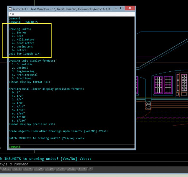

Have you run the command -DWGUNITS, hyphen required, to make sure your modelspace units are what you think they are? AutoCad Imperial templates default to inches.

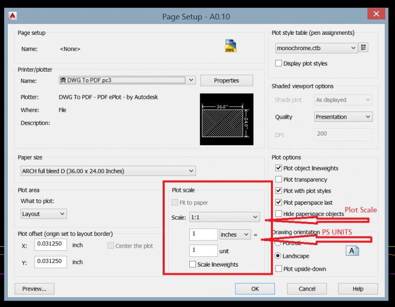

Make sure your paperspace unit is set to inches on the page setup dialog.
Don't monkey with the Plot Scale of 1:1 on the Plot or Page setup Dialog, unless you want to print a drawing on a reduced size paper for a one time deal. It's a whole different thing than viewport scale.

Yes, I'm sure my drawing is full size in model space (the LIST command shows that things are the correct length, for instance the length of the patio of the northern most building is 75 feet). The units in model space are in inches, which is the default.

Paperspace Units selection is right here.

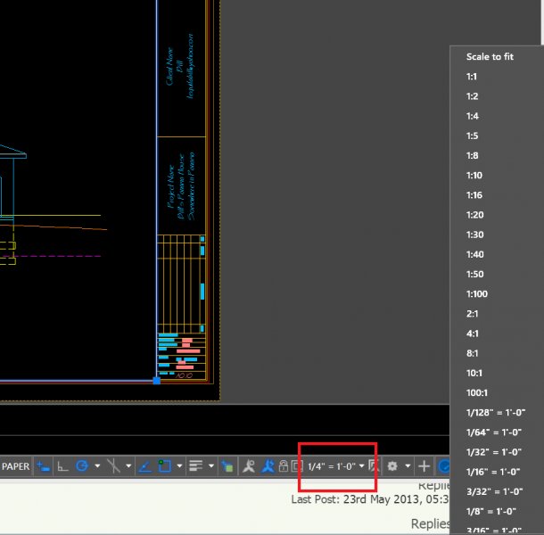

When scaling a viewport in 2015, and a couple releases back, one can simply select the viewport frame, then pick a scale from the Viewport Scale pop up menu on the task bar. Of course you have to have the Viewport Scale thingy selected for display on the taskbar in the first place. It saves us right brainers from having to deal with math stuff and pesky numbers.
