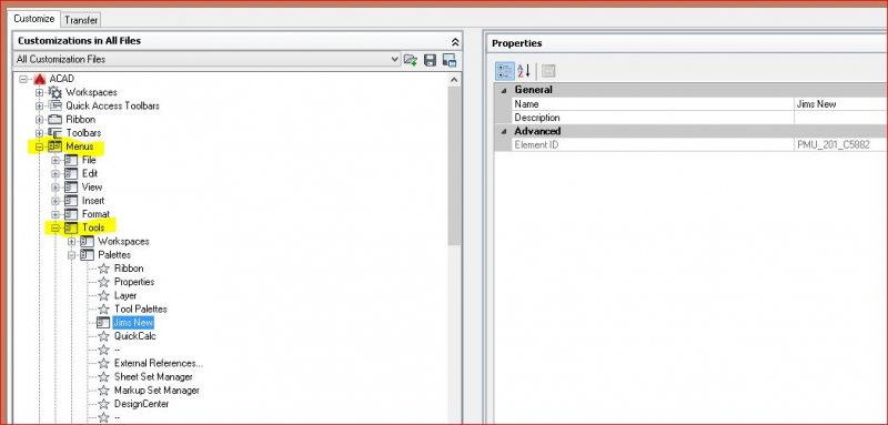

Dadgad Posted June 4, 2015 Posted June 4, 2015 You can create a new Menu or Sub-Menu where you want, by right clicking in the appropriate location in the CUI, and choosing it from the dropdown menu like in the screenshot. The drop down menu closes when the snipping tool opens, so it is not shown. Quote
