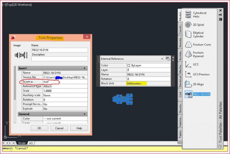

I just noticed that when insert blocks from the Toolpalette it changes the Block Unit of my blocks to Unitless. Why is this happening? My blocks are either imperial or metric but definitely not unitless. When I insert with the INSERT command the Block Unit remains unchanged.

Guitarguy, how are you applying the block to your tool palette?
If you copy the .dwg (from the drawing list) to the clipboard, then PASTE it onto the palette,
it will subsequently behave properly.
If you insert it, you can see in the dialog box, before selecting the insertion point that it is units mms, which will be maintained after insertion.
Click on the PROPERTIES (in the right click menu) for the icon on the tool palette, and look at the screenshot.
If you change INSERT AS to XREF, from block, the units will be properly maintained,
if as a block it will come in unitless, and I don't really know why that happens, but it does.
If you keep trying to do this in the same drawing, expecting a different result, make sure you purge between attempts.
If it has been XREFed in then the xref would need to be detached before redoing as an experiment.
Don't forget to check the -dwgunits of any drawing into which you are trying to insert it, if the results seem unexpected..

I appreciate your effots Dagdad. I'll try some of your suggestions.
Also in my experiments I found something else that is strange.
If I have a drawing and several Blocks in it I can drag one of those blocks to the Toolpalette and insert it via Toolpalette and the Block Unit will not change. However if the Block is its own drawing and I drag from Explorer to the Toolpalette then I will have the problem with the Block Unit.
