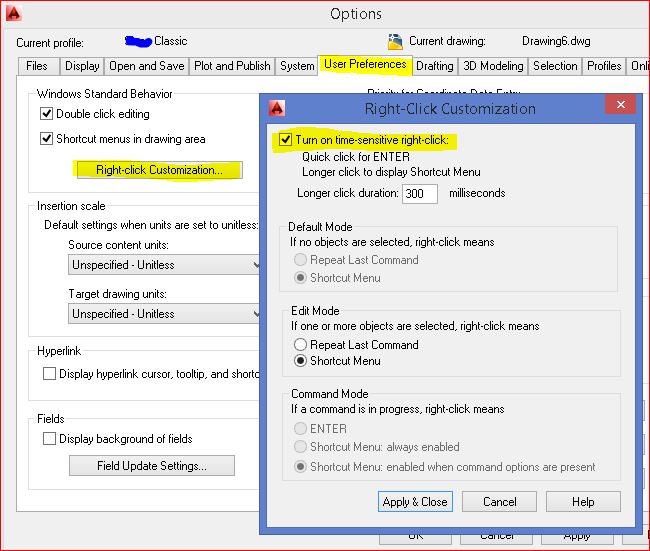

Do you use Time Sensitive right click customization possibly?
I do, just thought something might have changed there, if you do.
No. Is is currently unchecked.
