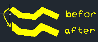

may i was not clear the polyline i used have a width ex 5 units so i want to set angle to start point vertex instead of perpendicular angle
Your words alone do not describe the problem. Let us all understand when you post a picture of what you want to do, and post the drawing (or the essential part of it) that you are using.
here is a shot picture
That probably isn't possible with a polyline. I think you have to "cap" the end of the polyline with another object.
You are not using the Pedit command properly. The Tangent option applies to curves. Your requirement has nothing to do with curves.
The only way to do this is to use something like creating a pline pattern and a hatch. Its complex and would be user specific in this case parallel to a line. I have code but I can not post for copyrite reasons.

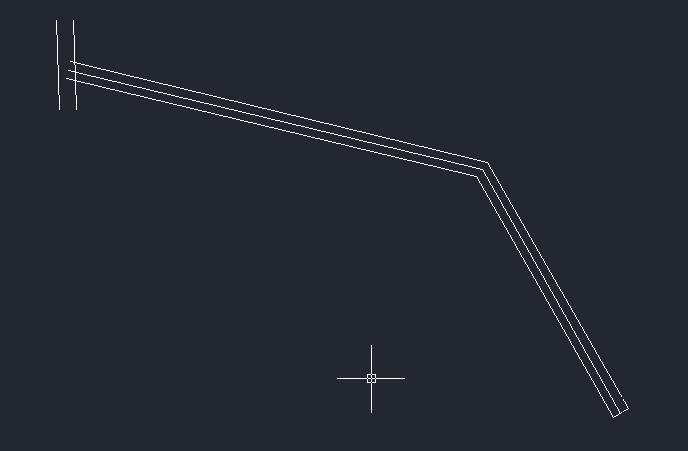

Do two offsets of the pline
add a offset to be trim line
trim at plines and line
close other end then hatch
