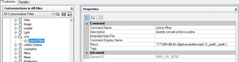

I probably won't for this lisp but here is what I use in my day to day. I have it stored under the mouse double click in the CUI. So all I have to do to convert a line to pline is double click on it. Then you can use the right click contextual menu to join it to whatever you want. The magic is in the double click though. So easy...
