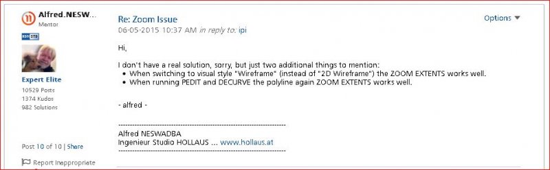

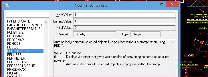

Dadgad Posted June 10, 2015 Share Posted June 10, 2015 (edited) Deam, CONVERTPOLY does not seem to work. Exploding 2D Polylines and PEDit > JOin is to much of a hassle This may help you a bit. Nice detective work Tiger! I checked out that link you posted, and found the last post very interesting. If you change your visualstyle to WIREFRAME, suddenly zoom extents works fine, unlike with visual style 2D Wireframe. Interesting bug. Check out the second screenshot for yet another approach from that post #10. Edited June 13, 2015 by Dadgad Quote Link to comment Share on other sites More sharing options...
