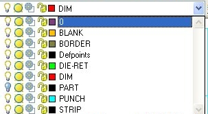

I just recently had to use a company machine that I do not normally use, as the draftsman assigned to it is on holiday. He is a lot more advanced at Autocad than I am and I noticed that he had his layers all set up with pre-assigned colors for machine parts. For example cams are in red, cam-followers are in blue, shafts are in green etc. Then he puts a legend on the bottom of a print with all the colors identified. My question is what would the name of this file be and would it be found in the Templates folder? Second question: How to go about setting this up initially? I leave a screen shot of an example for your view.
Thanking you in advance,

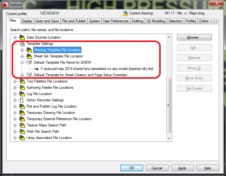

Did you start a new file using "QNEW"?
If so, check options for the path for QNEW.

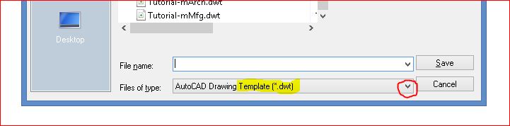

Any drawing can be SAVED as a .dwt (template file).
All you need to do is to open one and SAVE AS A .dwt file, as shown in the screenshot.
Once you have that, and set it as your QNEW default starting template, as Rob suggested, you are ready to go each time you start a new drawing.
