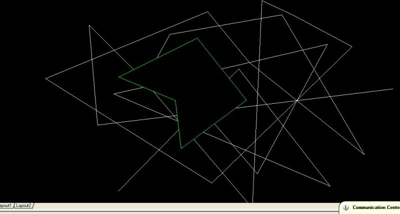

minhphuong_humg Posted June 11, 2015 Posted June 11, 2015 Hi, everybody. I have a drawing, I want erase all object inside or outside (2 case). Please, help me. Thank you very much. Quote

minhphuong_humg Posted June 11, 2015 Author Posted June 11, 2015 I think my description is clear if you are familiar in Lisp programming Ok, thank you Tharwat. I have a drawing autocad and which I draw a line enclosed (rectangle, polygon, or any). I want to choose boundary and then remove all of what is in it. Please see the attached figure: Quote
tombu Posted June 11, 2015 Posted June 11, 2015 See http://www.cadtutor.net/forum/showthread.php?92739-trim-rectangle-outside-object#14 for lisp with the function BoundaryTrim which will both trim and erase inside a selected boundary. Quote
minhphuong_humg Posted June 12, 2015 Author Posted June 12, 2015 See http://www.cadtutor.net/forum/showthread.php?92739-trim-rectangle-outside-object#14 for lisp with the function BoundaryTrim which will both trim and erase inside a selected boundary. Thank tombu very much! Quote
BIGAL Posted June 12, 2015 Posted June 12, 2015 (edited) Also Cookiecutter.lsp and like Lee I would use (extrim) Edited June 12, 2015 by BIGAL Quote

VVA Posted June 12, 2015 Posted June 12, 2015 some more links CookieCutter2 - more fun with ET extrim Inside a polyline SCWP - Select Contour Window PolygonSCCP - Select Contour Crossing Polygon OCD - OutSide Contour Delete sdop2.lsp - Select and Delete objects Outside of closed Polyline Quote
