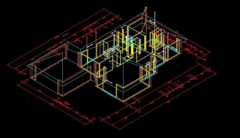

Somebody is abusing my good name :lol:, indeed LT cannot run LISP or many of the other programming languages, but in a lot of cases macro's and scripts can be made to do a lot of tasks (not all), add in a bit of diesel and it gets interesting, and if you have excel available then even better. The problem with LT is you have to forget the push button mentality. Sometimes even fairly straightforward tasks need a couple of extra steps, but you can usually find a way to semi automate most things (again not all). If you can give an explanation of what those Lisp's do and maybe some before and after results as images then somebody might be able to help. The 3D bit is debateable :twisted:

Off the top of my head I can't recall ever seeing another LT user entering a 3D modeling challenge, USING LT? :beer:
Steven-g are the following supported thickness, pface then this is possible.
Dadgad, I'm still very proud of my gold star for that one.
Bigal the thickness property is available, but not pface.
The walls are Thickness but sloping surfaces like the roofs are pface. It could be done as 3d line but obviously a hide will not show a 3D view. A pity there is no LT PRO that has lisp. LT LTPRO CIV3D etc
