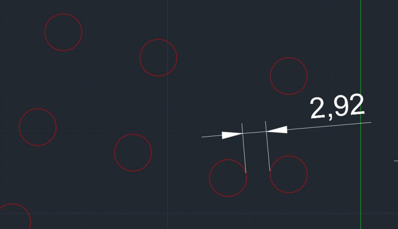

In my work I need to messure if cirkels are put to close together, is there a tool in AutoCad or a plug in, that can seek out cirkels that are to close. At one point I have seen a searching tool that could seek out lines that crosses, there for I thought maybe there was a way.
the lines I need to seek out is all that are closer then 1.5mm

I hope someone can help, and thanks upfront :)
There is no tool, native to AutoCAD, or plug-in that would tell you if two circles were too close. It might be possible using a custom lisp routine but I have no idea how such a routine would be written.

Try this program and let me know .
