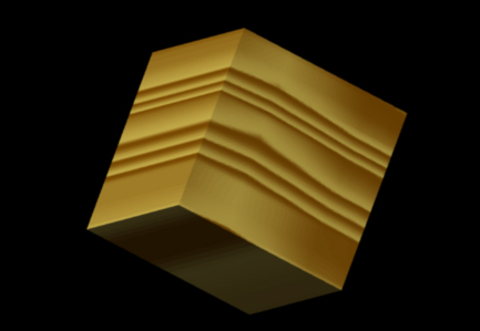

vinod Posted December 20, 2008 Posted December 20, 2008 Thankyou for all your previous help. Now I am here with a render screenshot. Please help me to get more realistic Wooden Block. I am using AutoCAD 2009. Quote
rustysilo Posted December 20, 2008 Posted December 20, 2008 That actually looks fairly realistic. You might try adding lights and such and toying around with the settings for the light(s) and render settings. I've been going through the same thing with a company logo. Quote

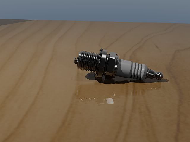

shift1313 Posted December 20, 2008 Posted December 20, 2008 how big is your block? under the materials settings you can adjust the bitmap size. it may make the grain more realistic and to scale(unless thats a really small block). Also 09 has two different(actually 4 but two are metal) settings. there is realistic material and advanced material. also you can play around with the other two maps to help the depth of the material. this was done in 09, standard wood material but i think i played with the reflectivity of it. lights and some sort of environment will really help you out as well. Do you have the sun turned on? Quote

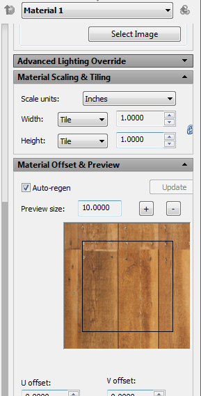

vinod Posted December 21, 2008 Author Posted December 21, 2008 just looking at your image id say the material map is much larger than your part. Try adjusting the material map(on the materials page there is an icon to the right of the image name, first one will let you edit the map, second one removes it) Here are my settings. Please check it. How can I get a perfect wooden finish shown in your image ? Quote
shift1313 Posted December 21, 2008 Posted December 21, 2008 thankfully i saved a screen shot of my table. I guess start by trying my settings and see where that gets you. Quote

vinod Posted December 22, 2008 Author Posted December 22, 2008 I played with material scaing and tiling.. Now the look is OK. Here you can see the settings and renderd image. Thanks for all. Quote
