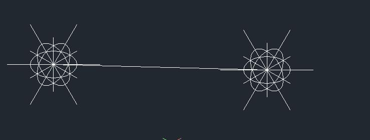

A little bit different I made this point 3 times but used rotate3d to rotate about the X and Y axis and join the 3 back to one using snap of node, you can still use ddptype to change shape and size. The way to go is either create a block of the two extra rotated points and place on existing or just add 2 points and rotate, will see if I can find time to do something.
Here is some sample code 2 versions a create 3d pt and a convert existing points to 3d pts
