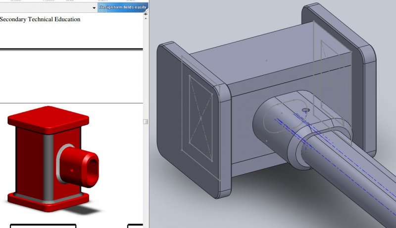

I'm trying to put some fillet welds on my assembly drawing but it would take two faces to create a weld..what might be the best way to do these...Im trying to make it look like the picture on the left

All the welds cannot be applied in one go, you have to do them individually.
e.g.
The Machined boss is welded to the top of the Hollow section
End plate 1 is welded to end 1 of the hollow section
End plate 2 is welded to the opposite end.
So, you should have 3 seperate welds in your feature tree.
In order to create the weld all you have to do is select the 1st face (top of hollow section) and then for second surface, select all the machined boss's surfaces that are in contact with the top of the hollow section

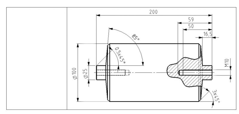

I'm having trouble with the 85 degree angle on the drawing..I tried to chamfer both sides of the cylinder to 3 x85 degrees but it didnt work..there was a build error.. what might be the best way to make this 85 degrees
Thanks..

I wouldn't add an 85Deg Chamfer.
It would be best to draw half the profile (omit the 45Deg Chamfers) as a sketch and then use the revolve command to complete the profile.
Then add 45Deg chamfers.
Then add in your two tapped holes.
Hope this helps.
Hi stevsmith,
Thank you it worked..thanks a lot :D
