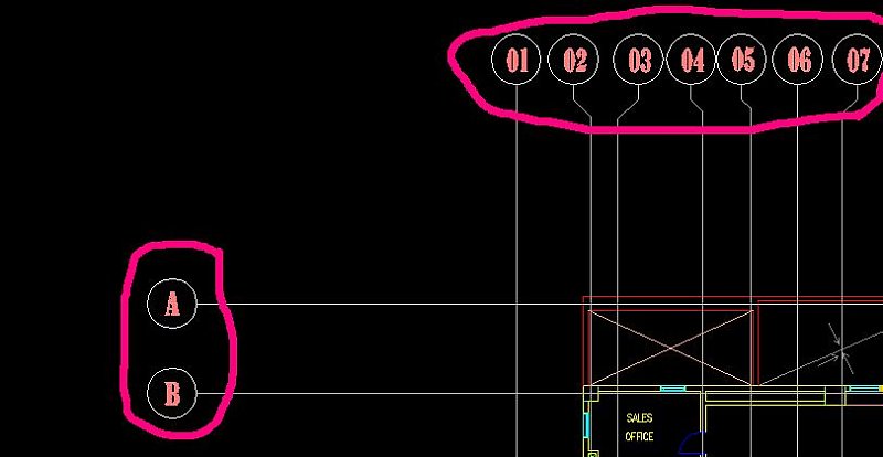

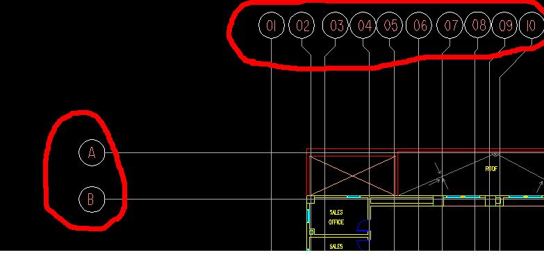

We have a project and the arch. Come out side the company and the drawing have a font STENCIL.shx it looking good for each machine except one
And I don’t know the reason may be variable or the graphic card …etc
Note this problem in AutoCAD 2008 and 2009
The attached may be explain more than me
Have any one help me in this problem
Thanks

Notice that the top font image is sans serif. The bottom font image is serif. They cannot be the same font.
