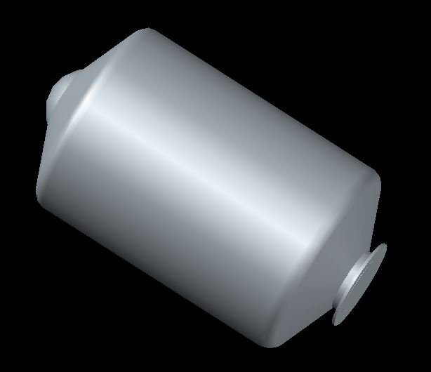

Assuming we are looking at cylindrical tanks you could create closed polyline half profile then use the REVOLVE command. Another option would be to try and build the tanks piecemeal by use such commands as EXTRUDE or PRESSPULL.
Here is an example created using the first method I suggested.
Sorry about the double images. It's been an ongoing problem of late.
It would be impossible to fully model everything in 3D since there is information missing that could only be obtained via another view or even two.

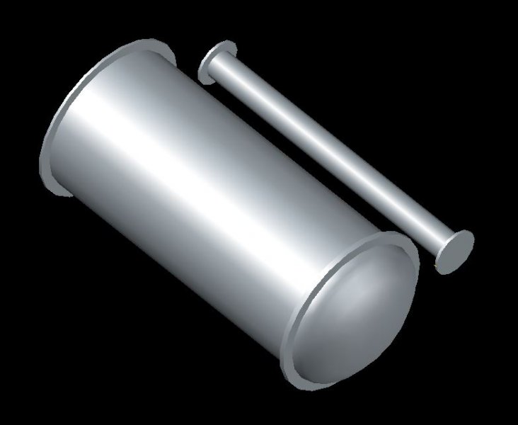

A couple more pieces of your equipment in 3D.

Thanks everyone, I ended up using the revolve command to get the best model i could do with the information provided. Yes, another view was needed.
ReMark, your images look the same as my finished product, and that certainly was what i was looking for.
