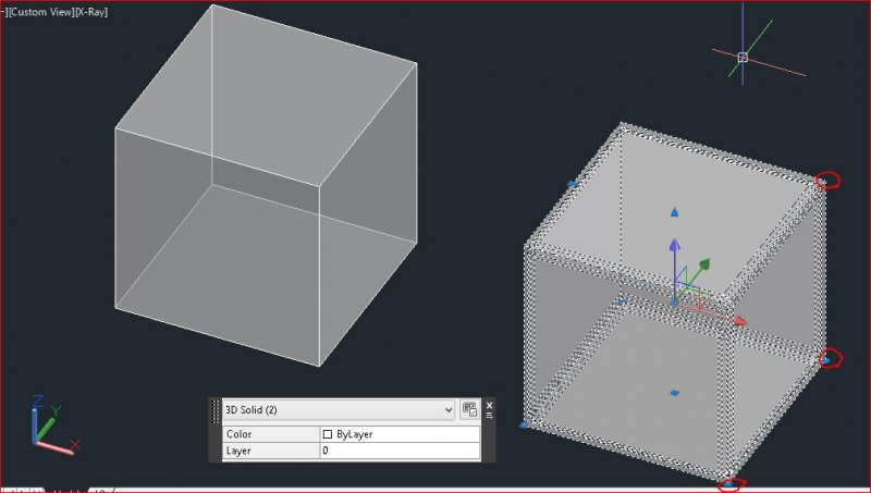

Here is a little visual of one way.
I created a copy of the cube, at a known distance, 2000 mms in this case, and radiused the edges with the radius solids tool from the solid editing toolbar.
Then I copied the original cube over by 2000 mms, and you can see the vertex reference points (I only circled 3 of them, but obviously they are all there).
Edited by Dadgad
