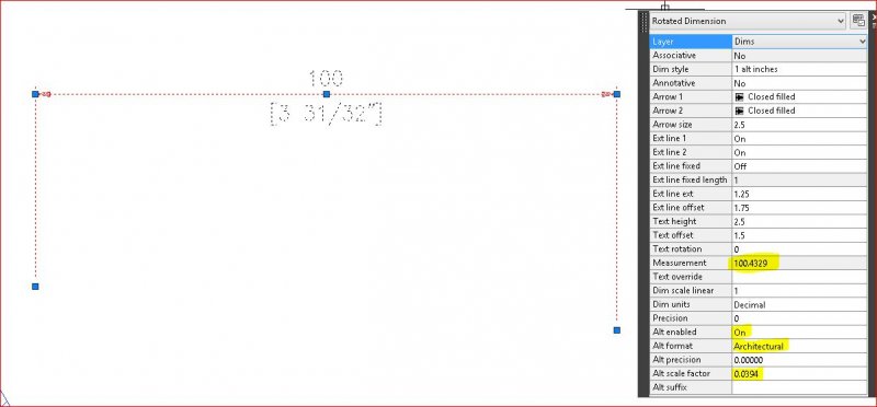

This is yet another possible way to deal with such an issue, as briefly noted at the end of my earlier post, should you wish to display both Imperial & Metric measurements.
In this case, the drawing is Metric, and I have specified to display the alternate units BELOW the dimension line.

In situations like this, it is sometimes not worth the time to fix someone else's mess. Start from scratch with a fresh file that has units set-up for your needs. Copy and paste or insert as a block the entire incoming drawing into that file. Scale as necessary. Change assigned dimstyles to your standards. There may be other adjustment necessary. Doing it this way will help you develop a procedure that should work for other incoming files. Although, I don't usually have to deal with metric to imperial conversions, I do have to deal with converting other companies CAD standards to ours and I find this to work quite well.

First the good news, yes, you have nailed it, your system is not setting the units to mms, that information is stored in the drawing. Your system is incapable of automagically causing that change, unless you used a custom lisp, or ran another command to make it happen. As to why the previous miscreant found that to be an appropriate thing to do? Anybody's guess. Failure to comprehend, the gift that goes on giving? Mostly just giving headaches to everybody else on down the line. :|
I am glad to hear that you were not the culprit, who monkeyed with the credibility of that drawing.
This exercise is a case study in why I like to use the -DWGUNITS command when receiving a drawing from elsewhere, first of all to assess the overall file.
Now for the bad news.
There are lots of users who don't have a very good handle on all of these UNITS related issues, especially the interactions between Imperial and Metric measuring systems.
It is a particularly bad idea, to accept drawings at face value, without having personally done a little due diligence.
You may recall that upon hearing initially that the MEASUREMENT setting for that drawing was , I said it sounded like it was probably created on an Imperial template (which, having dug appreciably deeper, seems to have been the case).
Upon noting the drawing units were mms, and seemingly at odds with the MEASUREMENT variable, one then needs to figure out which came first, the chicken or the fudge?
It becomes obvious that something is wrong, as those two variables should ideally be playing nicely together, as they are both meant to be pulling oars in the same boat.
The MEASUREMENT variable is saved in each drawing, and it controls the LINETYPE and HATCH files, as well as the default scale lists that will be used in that particular drawing.
On the whole, I would say that it is much more likely for a user (informed or otherwise) to alter the UNITS setting, than the MEASUREMENT variable, when trying to deal with such a problem.
That is why I always like to check that Variable (Measurement), and am less likely to doubt it.
As Rob suggests, it is often a good idea to start with a clean screen, and set it up yourself, as he describes in his post.
Typically I would say working in Imperial is easiest on an Imperial based template.
Why do you suppose the people who sent you the drawing felt they should change the Units to mms?
It seems to me that if they had left it as an Imperial drawing there would have been a lot less drama and trauma! :beer:
