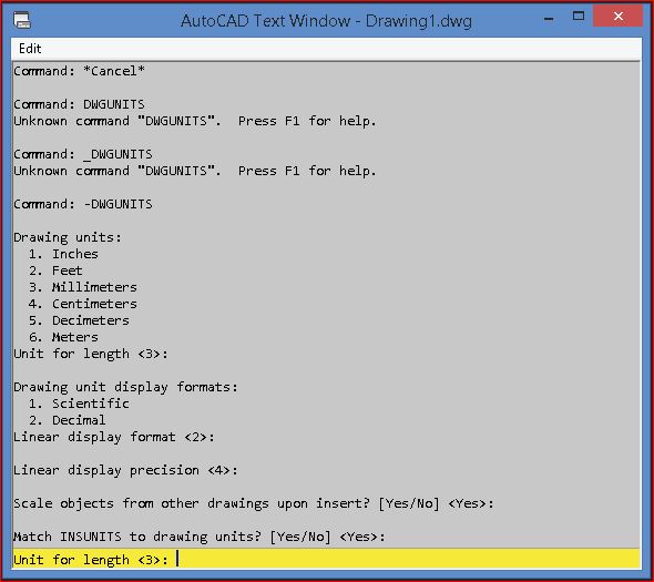

I don't have vanilla AutoCAD, I have the Mechanical version so I can't test this. Autodesk support is telling me -dwgunits doesn't exist in the vanilla product. Is that true? Can someone with vanilla try and then report back. I see this mentioned as a solution so often in here I assumed it was in the vanilla versions.
Works fine in plain vanilla 2011 Full.
How about DWGUNITS without the dash in front?
Thanks.
Dunno bout without the dash, but -dwgunits has been in vanilla AutoCad for a Loooooooonnng time. They even moved it into LT for 2015 (maybe before). LT definitely has no dwgunits without the dash.
Works in plain vanilla just great. This screenshot is from Vanilla 2013.
Had there been anything in Paperspace when I ran it, there would be an additional question about the option to scale paperspace entities too.
Just curious, if you open your version as Autocad, instead of as Mechanical, if you might have it available there?
As useful as it is, I am quite surprised that Autodesk support is unaware of it. :|

I was asking because in a vertical product using -dwgunits it will override the insunits setting, but it won't change insunits. So going through -dwgunits you might change to millimeters but insunits will still report inches. Supposedly in vanilla -dwgunits will also change insunits, maybe someone could report back on whether or not that happens.
I asked the Autodesk support for clarification but their answer seems wrong and or conflicting. For one they they state that -dwgunits isn't in vanilla AutoCAD.
Works fine here.
Default response is to NOT change the INSUNITS, if you just hit enter at the prompt. You must select Y, then enter.

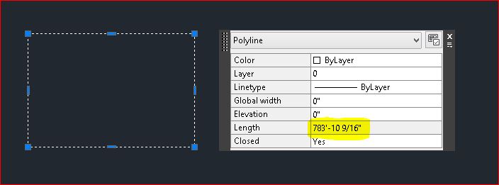

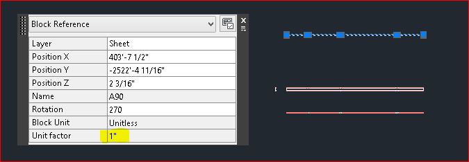

Drawing was Inches and Architectural.
