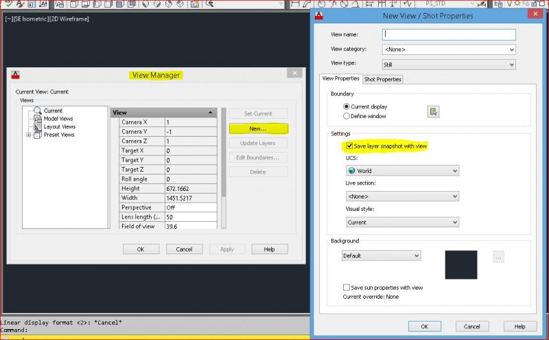

Or you can use the VIEW command to access the dialogues as shown in the screenshot, and you can create an appropriate view in your modelspace, then name and save it.
Later you can double click into a paperspace viewport, to activate it, then on your Views toolbar or Panel, select the view name which you just set up, and it will be applied to your active viewport.

Look at the image post above and type Vpoint 1,1,1 or Vpoint 1,0,0 should be rear, the first is a basic 3d view of the object by playing with the x y & z values including 1 or 0 to get a square on approach left right etc.
