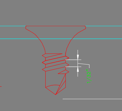

if the distance between twist lines on the screw is 1/32" how do I get it to jump to the next 1/32" instead of having the spacing not be equal?

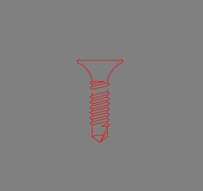

I do have the array command working, the issue is about the spacing. As you can see from the image if I am between array points it leaves a gap and what I want is to have it 'snap' to the next full "twist".
Hope that makes what I am looking for clearer.

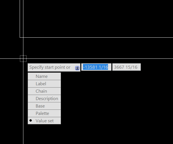

After selecting the linear parameter from the Authoring palette, and before clicking the first point for your distance, hit the down arrow so you get the set of selections in the first image. Then either click on VALUE SET or move the dot to it and hit enter.

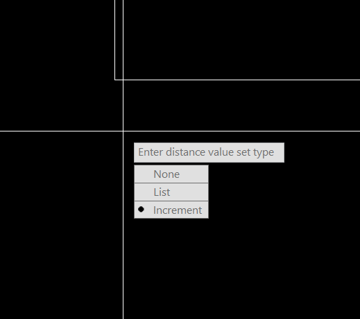

Then you will see the second image. There, select INCREMENTAL.

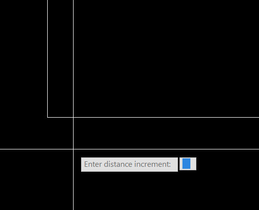

For the Third image, follow the prompts to enter your increment value, which will be 1/32", and then your minimum distance which can be no less than your increment value of 1/32", and then your maximum distance, which will probably be as long as the longest screw you are likely to need. Don't break the max distance into fractions smaller than your incremental value, like 29 3/64" or something.
