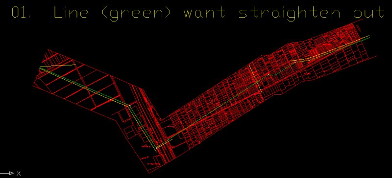

I design a road passing through a field with sharp corners. Now, I want to straighten out route but I do not know how. I used to do manually as follows: I draw the rectangle and then cut the rectangle; removal of the intersection (cross) and put together.
Please help me write a lisp that I do that line straighten out.
Sincerely thank you very much.
P / S: Default corridor road is 100m. I was offset to either side of the line is 100m.
Image attachment:
DWG file:
XDM L474.dwg
Here we go :)

Dear Tharwat,
Thank you very much. However, you can help me to step 04 (view file attach). You write to step 03 (not object in frames).
Thank Tharwat very much!
I want result this same:
Dear Tharwat,

Dear Tharwat,
At # 1 I also gave final image (I want this same result) I wanted have result this same.
And the figure 03 that was the idea that I think is after cutting out rectangles will merge them so.
And that's what I wanted at that time Figure 04. All roads have been straightened out.
Then because image have not numbered, so you may misunderstand me meaning.
I wish you ignore and please help me.
P / S: In a nutshell: I have a figured 01 I want straightened out the same figured 04.
Please help me!

Dear, BIGAL
I do not really understand much of Biggal. You can talk a little detail? I described the problems mentioned above:
I have one in route to the 01 drawings, now I want to straighten out as drawings route 04.
Look forward to your help and Tharwat.
Help me write a lisp to do so.
P/S: I'm using autocad 2007; I don't use Civil 3D.

I do understand you want to straighten out a curvy road to make plotting easier, we do it every day. As I said we use a layout and rotate the underlying survey to best suit the page, we use UCS when doing it manually per page to set view. I have a project 12 roads as a grid 15 degrees off vertical, all appear on the sheet as horizontal.
Ok start with your model space Then UCS OB either pick an object you want to make align to horizontly or draw a temporary line then use it you can then erase it , then UCS S "Road1" repeat for sections "road2" etc Then go to a layout set up your title block do a mview and do UCS R "road1" Plan, zoom in to correct area and at desired scale all done. Go to layout 2 UCS R "road2" plan Z E then scale etc just keep going. No programming required.

Dear, BIGAL
The purpose of stretching is to me put on longitudinal section (see attachment - yellow frame).
Although I did as instructed but when put into the layout I did not know how to do it again (see attached video).
I think, to put is in longitudinal section so it is necessary to use lisp or craft to straighten out. As for the method proposed BIGAL I think is not feasible.
We wish the help of BIGAL and Tharwat.
Thank you very much!

This is a bit like redoing again what has been asked before and you are really trying as you now say to produce long and cross sections a standard road design function. There is lots of free stuff out there to do just this. Search here for posts by ymg3 he has some nice routines and I am pretty sure he has now added long section to his collection, I am sure he will comment.
minhphuong_humg,
I really do not understand your purpose in straightening your alignment.
Only reason would be for presentation purpose as BIGAL mentionned.
To extract long section all you need is a triangulation of your corridor
then extract a profile out of it.
Or maybe you want to show profile along with a developped plan view
of the parcels where the alignment passes.
If it is the case, Tharwat's routine gives you the windows for each
segment. Armed with that you need a cookie cutter routine that
will return a copy of all the entities inside the windows trimmed to
that window.
You then need to rotate each of the trimmed window to 0 degree
and place them end to end.
I do have a long profile extraction from a Triangulation in my Triang
program.
In one of the version (Not the last one) I had a routine OSD which
could trim all entities to an external contour. But II do not have a
routine that will do what you want.
If you search this site or the web for cookie cutter or trim to external
contour you will find many.
ymg

Dear ymg3,
Thank you for your interest in this issue.
The purpose of straightening out I was presented as at # 10 that I put on the description of longitudinal section (yellow frame in longitudinal section - attachment # 10). Because in longitudinal section should straighten out the corner without leaving the (corresponding to angle = 0).
Please help me to do that without having to manually cut each rectangle and fit together.

Dear BIGAL,
Dear ymg3,
Dear Tharwat,
Dear Everybody,
Let me once again say the problems that I need help.
I surveyed the route then draw longitudinal section.
Because on the longitudinal section presents the fashion show as 0 degrees so I have to straighten out.
To do that, I do crafts is very long.
Now we hope to receive your help so that I can perform the job more quickly.
English is not my mother tongue. So sometimes I describe its improper intent. I'm looking for sympathy and help.
See drawings detailing the steps taken my job.
Thank you very much! Good luck for you!

minhphuong_humg, I do think that everyone is trying to help you.
But, speaking personally, I have never seen a drawing such as yours in 50 years.
Usually, roads have curves which join up the straights. Perhaps this is not a road for vehicles?
How would you suggest showing the background mapping if you were to straighten out a curve?
The longitudinal section is, by its own definition, a straightened out centre-line, and is usually referenced to the plan view by the chainage markers.
Your wish is for a lisp to do what has never been done before, and will not be useful to anyone else, and it might take time for someone to write.

add a profile on a grid.
Dear ymg3,
The problem is that my company profile is required to do so before the design. I am the staff can not do otherwise. The only other thing that could do something to be able to make faster only.
Thank you for your interest in my problem.
If you can look forward to receiving your help!
Sincere thanks to all of you!
