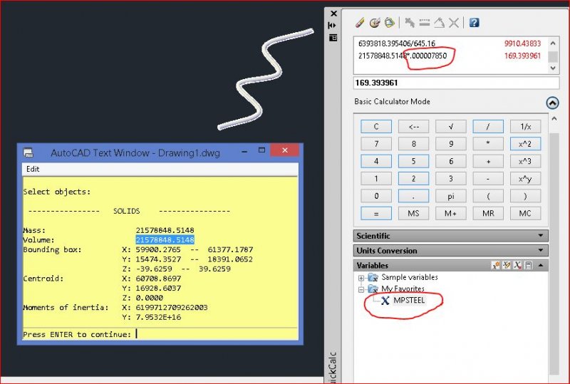

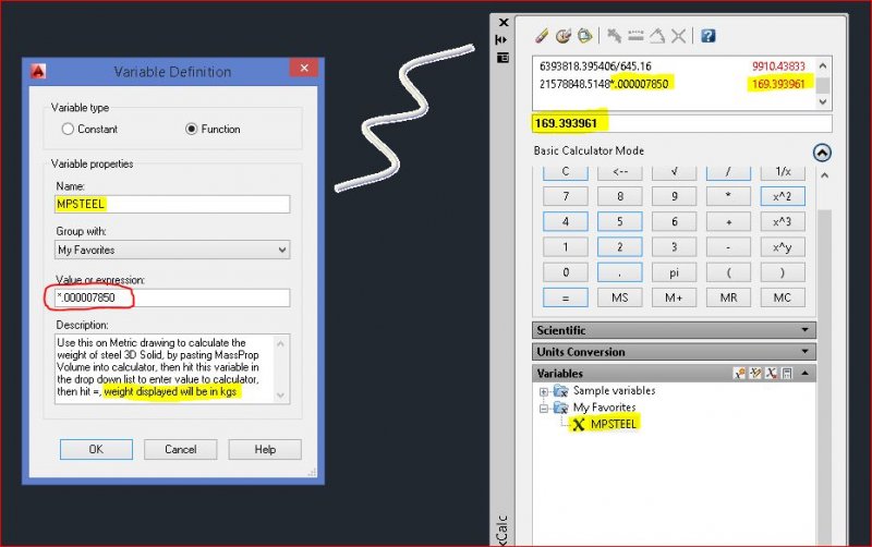

Dadgad Posted July 23, 2015 Posted July 23, 2015 (edited) You can set up custom Variables below your calculator, use *............, and fill in with the mass of the material in question. You will still need to copy and paste from massprop into your quick calculator, then click on the variable and hit = . Not great but will stop you having to remember or enter all of the different material masses each time. Edited July 24, 2015 by Dadgad Quote
MechanicalAnimal Posted July 23, 2015 Author Posted July 23, 2015 That is helpful Dadgad, I may have to resort to using this. If I were to resort to a LISP, is there a command that would allow me to pull the VOLUME amount from the mass properties? Sort of like a GETPOINT command but able to retrieve the volume amount. This way I could do the math right within the program. Quote

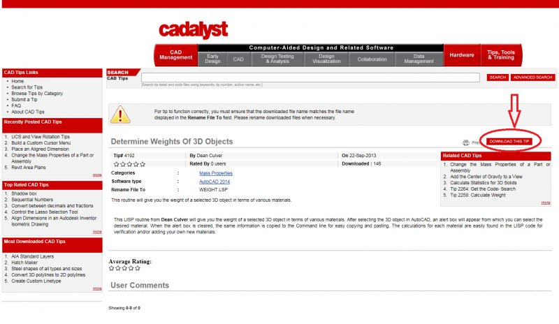

SLW210 Posted July 24, 2015 Posted July 24, 2015 Give this LISP a try...http://cadtips.cadalyst.com/mass-properties/determine-weights-3d-objects Quote
MechanicalAnimal Posted July 24, 2015 Author Posted July 24, 2015 SLW210, I realized how ridiculous this is going to sound but for some reason when I click on that link there is nowhere for me to dl the lisp. I see where it says "WEIGHT.LSP" but it is not a hyperlink. Do I have to have an account through cadalyst in order to dl this? Quote
Dadgad Posted July 24, 2015 Posted July 24, 2015 SLW210, I realized how ridiculous this is going to sound but for some reason when I click on that link there is nowhere for me to dl the lisp. I see where it says "WEIGHT.LSP" but it is not a hyperlink. Do I have to have an account through cadalyst in order to dl this? No, I don't believe you do, I liked the look of this lisp, so I just downloaded it, but you will need to scroll to the second page of downloads. I didn't sign in, and was able to download it. Good tip SLW, thanks. Quote
SLW210 Posted July 24, 2015 Posted July 24, 2015 SLW210, I realized how ridiculous this is going to sound but for some reason when I click on that link there is nowhere for me to dl the lisp. I see where it says "WEIGHT.LSP" but it is not a hyperlink. Do I have to have an account through cadalyst in order to dl this? Click on "DOWNLOAD THIS TIP" at upper right next to the Print Icon. Quote
Dadgad Posted July 24, 2015 Posted July 24, 2015 This is a cool lisp, but I just tried it, and it only supports Imperial units as written, Were I not so tired, I would try to tweak it so as to embrace Metric volumes, perhaps on the morrow. Quote
