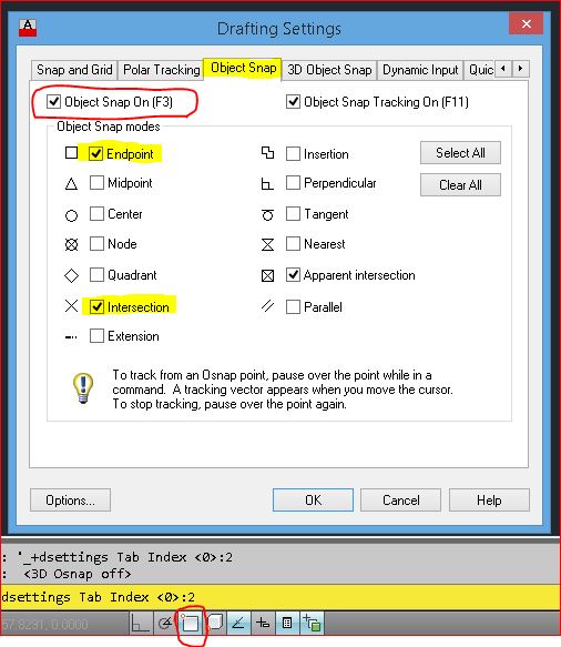

Turn on and use your O Snaps, and it will be very simple to align them accurately.
You could also do it with your 3D OSnaps, but there is really no need to, as these will do it.
Try the "3dmove" command with osnaps as Dadgad replied.
