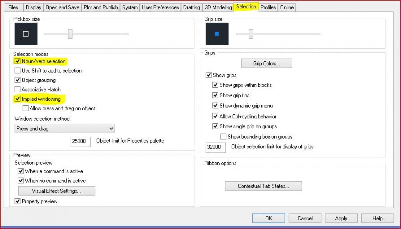

It sounds like the problem you are experiencing is probably related to variables which can be easily defined in OPTIONS, on the SELECTION tab.
Open your OPTIONS, and compare your settings to those in the screenshot.

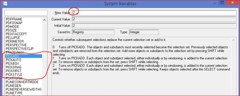

I have also included a screenshot taken from the dialogue box for the SYSVDLG command, wherein you can find comprehensive descriptions of the effects of different variable settings on all of the different system variables.
You may want to check your PICKADD setting.
2nd dadgad the NOUN/VERB is the one that gets most people,
select objects then do command
do command then select objects
