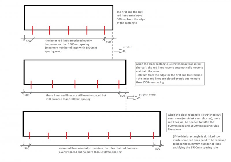

jasonle215 Posted August 3, 2015 Posted August 3, 2015 Hi guys, I have this problem and I hope you guys could help me solve. I would appreciate a lot The problem is describe in this photo below. If I miss out any information, please let me know. I'm not sure whether to create an Autolisp to define a special stretch command to do this. Or whether to create the rectangle and the red lines in a block so they behave more interactive to stretching) Quote

SLW210 Posted August 3, 2015 Posted August 3, 2015 Is there a minimum distance for the middle red lines and/or a certain amount of lines at any given distance of the rectangle? Quote

marko_ribar Posted August 3, 2015 Posted August 3, 2015 Do you know what drawing you want to get as a result, jasonle215? In other words, what's the purpose of dynamic arraying lines along the path while stretching if it isn't just for testing how AutoCAD handle this task for which you don't really have a good justification and may in some scenario using reactors (like David stated) even crash while performing this action... Quote
marko_ribar Posted August 3, 2015 Posted August 3, 2015 (edited) Is there a minimum distance for the middle red lines and/or a certain amount of lines at any given distance of the rectangle? Minimal distance is varying : * length = 2500 (2500 - (2x500); edges = 1500 in between (max. dist) => 0 line 1 space 1500... length = 2501 (2501 - (2x500); edges = 1501 in between => 1 line divides 1501 on 2 spaces each little > 750 (min. distance)) * length = 4000 (4000 - (2x500); edges = 3000 in between => 1 line divides 3000 on 2 spaces each 1500 (max. distance)) length = 4001 (4001 - (2x500); edges = 3001 in between => 2 lines divides 3001 on 3 spaces each little > 1000 (min. distance)) * length = 5500 (5500 - (2x500); edges = 4500 in between => 2 lines divides 4500 on 3 spaces each 1500 (max. distance)) length = 5501 (5501 - (2x500); edges = 4501 in between => 3 lines divides 4501 on 4 spaces each little > 1125 (min. distance)) ... and so on ... * length = 16000 (16000 - (2x500); edges = 15000 in between => 9 lines divides 15000 on 10 spaces each 1500 (max. distance)) length = 16001 (16001 - (2x500); edges = 15001 in between => 10 lines divides 15001 on 11 spaces each little > 1363.6363 (min. distance)) ... * length = 151000 (151000 - (2x500); edges = 150000 in between => 99 lines divides 150000 on 100 spaces each 1500 (max. distance)) length = 151001 (151001 - (2x500); edges = 150001 in between => 100 lines divides 150001 on 101 spaces each little > 1485.1485 (min. distance)) ... if length -> ~ => max. distance = min. distance = 1500 and number of lines -> ~ Edited August 3, 2015 by marko_ribar Quote

iconeo Posted August 3, 2015 Posted August 3, 2015 test_by_chau.dwg Needs a bit of cleaning up but you should be able to get there from here. Quote

jasonle215 Posted August 4, 2015 Author Posted August 4, 2015 [ATTACH]55078[/ATTACH] Needs a bit of cleaning up but you should be able to get there from here. Hi Iconeo, Thank you for making this for me. I was wondering if you could describe how create this block and with what constraint elements? I'm just trying to make this on my own but I'm not familiar with block. Thank you. Quote
Dadgad Posted August 4, 2015 Posted August 4, 2015 I checked out Iconeos dynamic block earlier, and tried to tweak it a bit, as it will exceed the 1500 measurement by a small amount before adding another element into the array, but I failed to get it sorted. BIGAL's post is a bit of a different animal, because the stretch action parameter is Incremental, instead of infinite, but still gives you a pretty good idea about the whole concept of dynamicism in blocks. Quote
jasonle215 Posted August 4, 2015 Author Posted August 4, 2015 I checked out Iconeos dynamic block earlier, and tried to tweak it a bit, as it will exceed the 1500 measurement by a small amount before adding another element into the array, but I failed to get it sorted. BIGAL's post is a bit of a different animal, because the stretch action parameter is Incremental, instead of infinite, but still gives you a pretty good idea about the whole concept of dynamicism in blocks. yeah, I think Iconeo's dynamic block is exactly what I need but I can't seem to replicate this on my own. Can you give me a tutorial how the stretching works for the red lines? I assume it has something to do with array but I can't seem to do it. I would appreciate a lot if you could show me. Thanks heaps!!!! Quote
marko_ribar Posted August 4, 2015 Posted August 4, 2015 Hi jasonale215, I've modified Iconeo's dynamic block to suit my analysis... HTH, M.R. (You have to click on both arrows for stretching)... test_by_chau.dwg Quote
jasonle215 Posted August 4, 2015 Author Posted August 4, 2015 Hi jasonale215, I've modified Iconeo's dynamic block to suit my analysis... HTH, M.R. (You have to click on both arrows for stretching)... [ATTACH]55088[/ATTACH] Thanks Marko_ribar, I think Iconeo's dynamic block is the answer for my problem. However I don't know how he/she could use the expression for the Array Items as "arraycount+1" . I tried typing that in but CAD recognize my expression. Do you have any idea?. Thanks Quote
marko_ribar Posted August 4, 2015 Posted August 4, 2015 While editing block, click on array path object ( small vertical lines - black ) and type ctrl+1 - property... Then in cell for number of item - just below (method - Divide), type d4/1500+2 as an expression... This is how I managed to set up array by path... Of course, you have to set up firstly d4 dimension and other constraints parameters... HTH, M.R. Quote
Dadgad Posted August 4, 2015 Posted August 4, 2015 (edited) While editing block, click on array path object ( small vertical lines - black ) and type ctrl+1 - property... Then in cell for number of item - just below (method - Divide), type d4/1500+2 as an expression... This is how I managed to set up array by path... Of course, you have to set up firstly d4 dimension and other constraints parameters... HTH, M.R. Thanks for your input Marko, you have reinvigorated me to go back and try again, as it was entering that expression which was giving me trouble. Edited August 5, 2015 by Dadgad Quote
