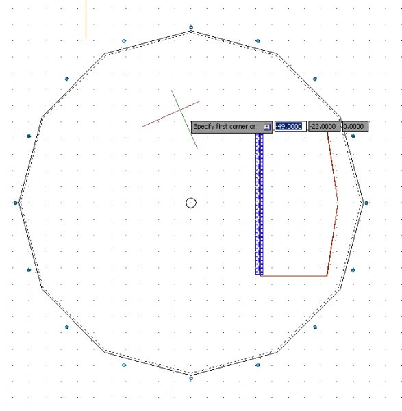

attachment.php?attachmentid=55118&cid=1&stc=1USC World did not do the trick..
Look at the screen capture.. My crosshairs are at a weird 45 deg angle.. Like it wants to draw isometric.. If I move the cursor out of the big circle, it works fine.. inside the circle will only let me draw 45 deg angles.
What is going on?
Looks like I might have fixed it.. at the bottom left of my screen are a bunch of gray and blue boxes with icons in them.. Ortho on/off and object snap tracking on/off.. it was one of them.. I just turned it all off..
If this is a 3D object, it looks like it's the Dynamic UCS that's enabling when you hover over the "face" of the top object. This can be toggled in the row of application status bar.
