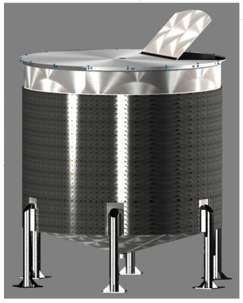

Murphy625 Posted August 5, 2015 Posted August 5, 2015 Take a look at the image below.. Its a 2000 gallon stainless tank (Kettle) with a dimpled heating jacket. The dimple jacket is just an image that I wrapped around.. Notice the vertical band of distortion?? I can't seem to make it go away. It would appear there are two of these bands on opposite sides of the tank. I've tried screwing with the mapping and the image sample size but it just gets worse. Any ideas? Quote

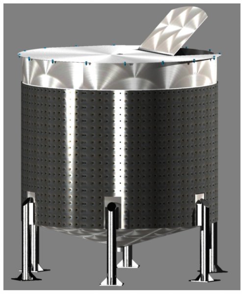

Murphy625 Posted August 5, 2015 Author Posted August 5, 2015 I don't know why it stuck the image in there twice. Is anyone else seeing that? Quote
ReMark Posted August 5, 2015 Posted August 5, 2015 What if you did a quadrant of the tank and assuming it came out OK then use the array command to fill in the other three quadrants? Quote
Murphy625 Posted August 5, 2015 Author Posted August 5, 2015 What if you did a quadrant of the tank and assuming it came out OK then use the array command to fill in the other three quadrants? I just tried that and it worked for about 10 seconds until I changed views.. Then, the entire jacket disappeared from the drawing during the render... So I exploded the array and the material disappeared from the 3 new sections and only stayed on the original.. When I tried to apply the material to the three sections, the mapping was all screwy again on those three.. Is there a way to transfer ALL of the properties including the mapping? Quote

Cad64 Posted August 6, 2015 Posted August 6, 2015 So you have already tried adjusting the Cylindrical mapping? http://knowledge.autodesk.com/support/autocad/getting-started/caas/CloudHelp/cloudhelp/2016/ENU/AutoCAD-Core/files/GUID-ADC70514-B2D8-4779-99D8-609641184208-htm.html What does the original texture map look like? Is it tileable? Quote
Murphy625 Posted August 6, 2015 Author Posted August 6, 2015 So you have already tried adjusting the Cylindrical mapping? http://knowledge.autodesk.com/support/autocad/getting-started/caas/CloudHelp/cloudhelp/2016/ENU/AutoCAD-Core/files/GUID-ADC70514-B2D8-4779-99D8-609641184208-htm.html What does the original texture map look like? Is it tileable? I tried cylindrical mapping and it looked very bad. I edited the original jpg file in photoshop so that it would be tileable with little or no adverse affects like those ugly boarder lines or colors that don't match. I did end up with a work around.. I split the circumference in two parts, used planar mapping and then just moved them together without joining the solids.. Seems to have worked pretty good without any distortions.. Here's what I have so far... Quote
