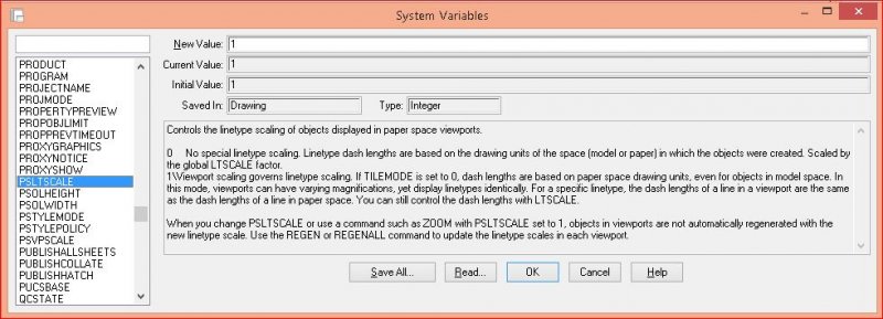

A little more grist for the mill, from the SYSVDLG description.
