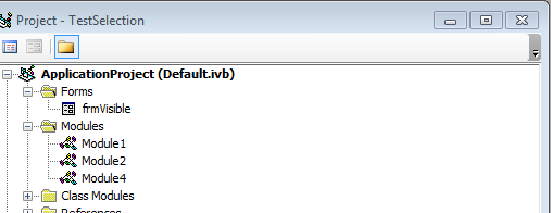

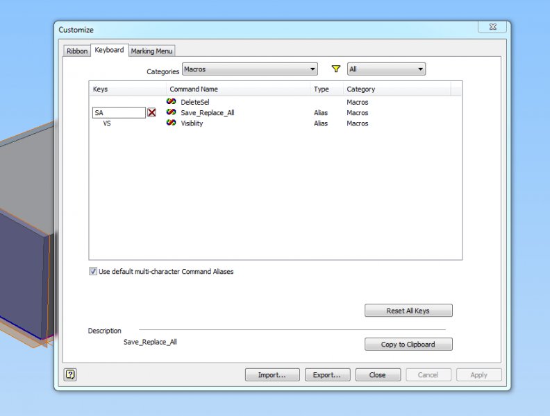

ok , found a way . if someone is intrested
the vb module must be in the apllication projects (default.ivb) , see imageps.PNG
then in invetor you go to "Tools" tab> Customize> second tab "Keyboard" rule down and choose "macros" then on the left type the shotrcut sa.jpg
