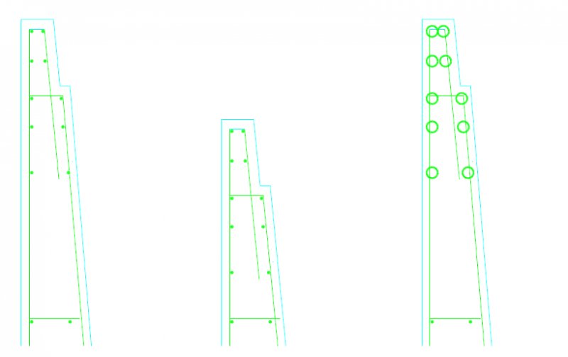

THE WEAR THING IS THAT IN OTHER COMPUTER ITS WORK FINE
I ATTACH EXAMPLE OF THE STRETCH THAT I WANT TO DO.
